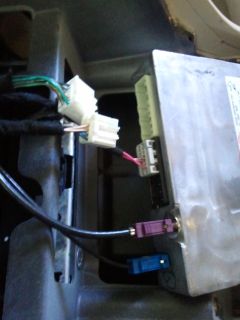

Now you will see a larger silver box it is clipped in a plastic enclosure. Pop it out and help guide the wires out so you have more access. then unplug the two white plugs in slots j1 and j2. My on star had j3 populated so I left it and everything else plugged in and popped it back in. I used Velcro to attach the bluestar box to the top of the onstar box. Then I plugged the two white connecters in to the bluestar box and installed it on top of the onstar box.

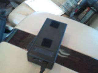

bluestar velc.jpg (12.98 KiB) Viewed 47497 times

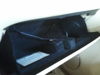

optional- I ran a usb cable from the bluestar box to my glovebox. This way it will be easier to update the bluestar unit.

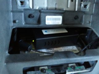

I think this is the on star vcim
