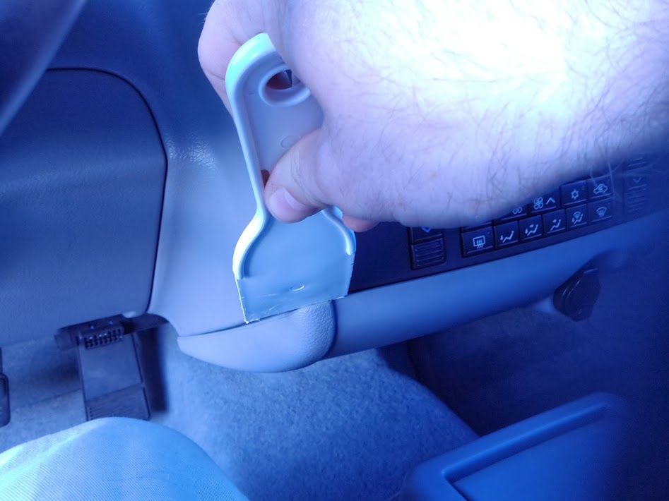

1. The OnStar unit can be found under the dash by removing the bottom of the center console. I happened to have a plastic spatula/scraper from a drywall repair kit, and that worked well-- without damaging my console. I believe the best technique is to insert the tool into the front corners of the bottom panel of the console as shown here:

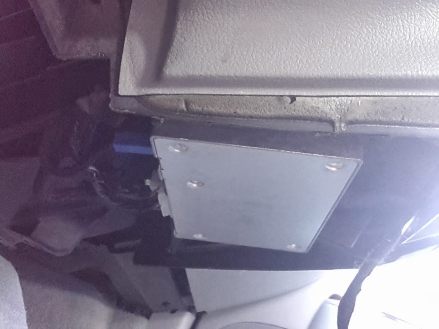

2. The actual J1 & J2 plugs that are fastened to the OEM OnStar box are probably best viewed from the passenger-side foot well, but all of my photos are taken from the driver's side (U.S model vehicle) because I didn't realize until after I was well under way that this was the case. After I managed to pull the bottom of the console off, I became a circus contortionist and wedged my torso into the proper position to look up into the wiring underneath the dashboard. I *think* you may be able to complete this whole process in about 5 minutes by simply unplugging the J-plugs from your current OnStar board and then plugging them into your BluStar unit, shove it up into the dash and you're done. I was not that fortunate, because I was compelled to attempt a better form of installation which proved to not be possible. That said, here is the photo of the OEM OnStar box in my vehicle (looking up into the dash from under the steering wheel):

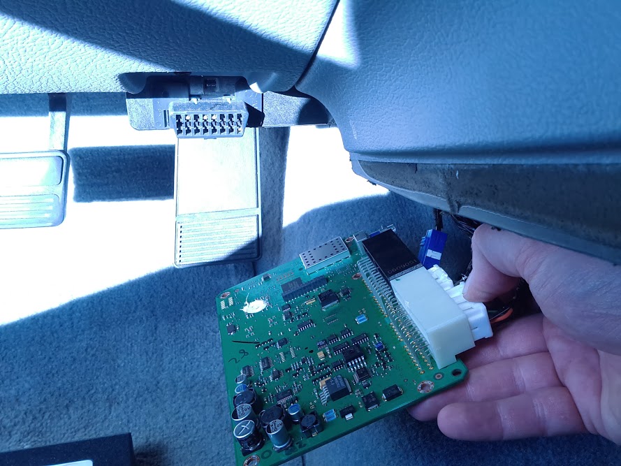

3. The J-plugs can be removed by pressing down on the small tab and pulling as shown here:

4. Then all you have to do is insert the plugs into the Blustar box (which can't be shown due to limited pictures/attachments on this forum).
5. I wanted to put the Blustar box into the OEM box/casing, but the board of the BluStar is longer than the OEM OnStar version so that was not really possible. I decided the best solution was just to plug in the BluStar box, shove it up into the wiring area, reassemble the factory OnStar box (just in case I ever needed to revert for some reason), and then replace the bottom panel of the console.
